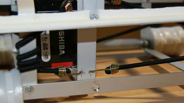

                              Guckst Du hier:
                              This is the final Version of my Camera Framefor my Toshiba Camileo S10 HD-Cam, built with bungee-cords and door-stopping rubbers.
