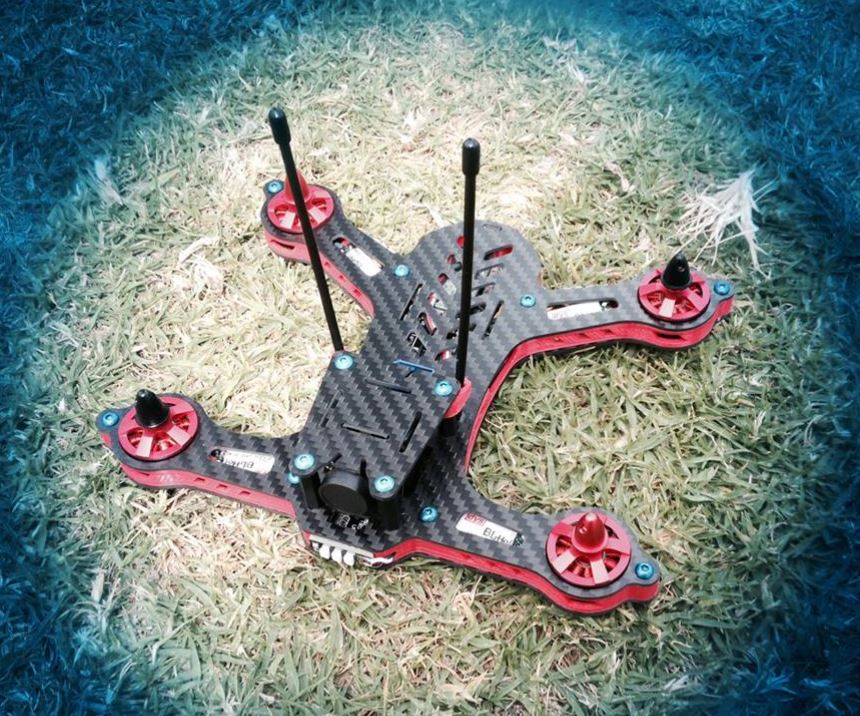

      ...auch kein schlechtes Konzept für nen kleinen Racer
      ...oder hier...mit ein paar schönen CFK-Platten statt den Plates aus´m 3D-Drucker...
      This quad is based on the sigan 180 quad.The final object will not have the same solidity as the original frame from http://sigandrone.com/Video :https://www.youtube.com/watch?v=xT-9P1em3u0Beta version of fully printable little racerDesign still in progress...All suggestions are welcome.[UPDATE 02/08/2016]Dxf files are attached for carbon cuting.[UPDATE 12/22/2015]Hardware list (exemple) :Motor 1806 + 16A esc :http://www.banggood.com/4X-DYS-BE1806-2300KV-Brushless-Motor-with-4X-DYS-BL16A-Mini-16A-BLHeli-ESC-p-995110.html?p=QK2903081680201209NSFC :http://www.banggood.com/Afro-Naze32-10DOF-Rev5-MPU6050-Flight-controller-p-1007113.html?p=QK2903081680201209NSDistribution board :http://www.banggood.com/Matek-Mini-Power-Hub-Power-Distribution-Board-With-BEC-5V-And-12V-For-FPV-Multicopter-p-1005549.html?p=QK2903081680201209NSProps :http://www.banggood.com/HQProp-Bullnose-4045-4X4_5-Carbon-Fiber-Mix-2-PCS-CW-CCW-For-RC-Multirotor-p-998590.html?p=QK2903081680201209NSLipo :http://www.hobbyking.com/hobbyking/store/__26704__Turnigy_nano_tech_1300mAh_3S_45_90C_Lipo_Pack_UK_Warehouse_.html?strSearch=1300Vtx :http://www.banggood.com/Skyzone-Upgrade-TS5823S-40CH-5_8G-200MW-AV-Transmitter-Module-RP-SMA-Female-p-1017491.html?p=QK2903081680201209NSCamera : (not tested)http://www.banggood.com/Aomway-700TVL-HD-13-CMOS-FPV-Camera-170-Degree-Wide-Angle-Lens-Module-NTSC-PAL-p-984884.html?p=QK2903081680201209NS[UPDATE 12/20/2015] New top part addded (up to camera) Ans somes pics of the quad mounted.[UPDATE 12/12/2015] One friend have design this model with more compeytence than me and is model is really nice too (ideal for carbon cutting version) :http://www.thingiverse.com/thing:1187311/#files
      ...nur mal so als Idee...

        Hübsch und i.wie frech mit den versenkten Motoren, dünnen Plates etc.
        Gibt's auch so einen kleinen mit Carbonröhren anstatt platten Platten-Armen, so was wie ein Mini-Vortex? Schon mal was gesehen?
        Ich denk, bei den kleinen Props geht doch schon an den relativ breiten Armen so einiges verloren...

            Thx aber ich meinte eben kleiner, so 180er Grösse und auf 1806 ausgelegt stell ich mir das fein vor, da könnten Rohre oder Profilteile relativ dünn bleiben...
            Problem ist dann nur, wohin mit den Escs...

                ...bin kein Fan von Rohrauslegern.
                Sieht gut aus, keine Frage, aber bei POM-Schellen auf CFK kann man das imho gar nicht so fest anziehen, daß sich die Motorwinkel nach einem Crash nicht verstellen würden.
                Und dann darfst man jedesmal die Motoren wieder genau ausrichten - wenn einer nicht passt, hast immer ungewollte Drehung um die Hochachse.
                Ich denke, schöne, starke Plattenausleger sind die bessere Wahl.
                    Genau den wollte ich mir mal drucken, bin aber nicht so sicher, wie haltbar das Ganze dann ist.
                    Optimal wäre es wirklich, wenn jemand die Deck und die Bodenplatte fräsen würde
                      #6760
                      Ja ich denke mal, "nur" gedruckt ist das Teilchen nicht stabil genug...außer Du hast nen Lasersinterdrucker...
                      Aber mit Top- und Bottomplate aus CFK sollte es schon anders aussehen...
