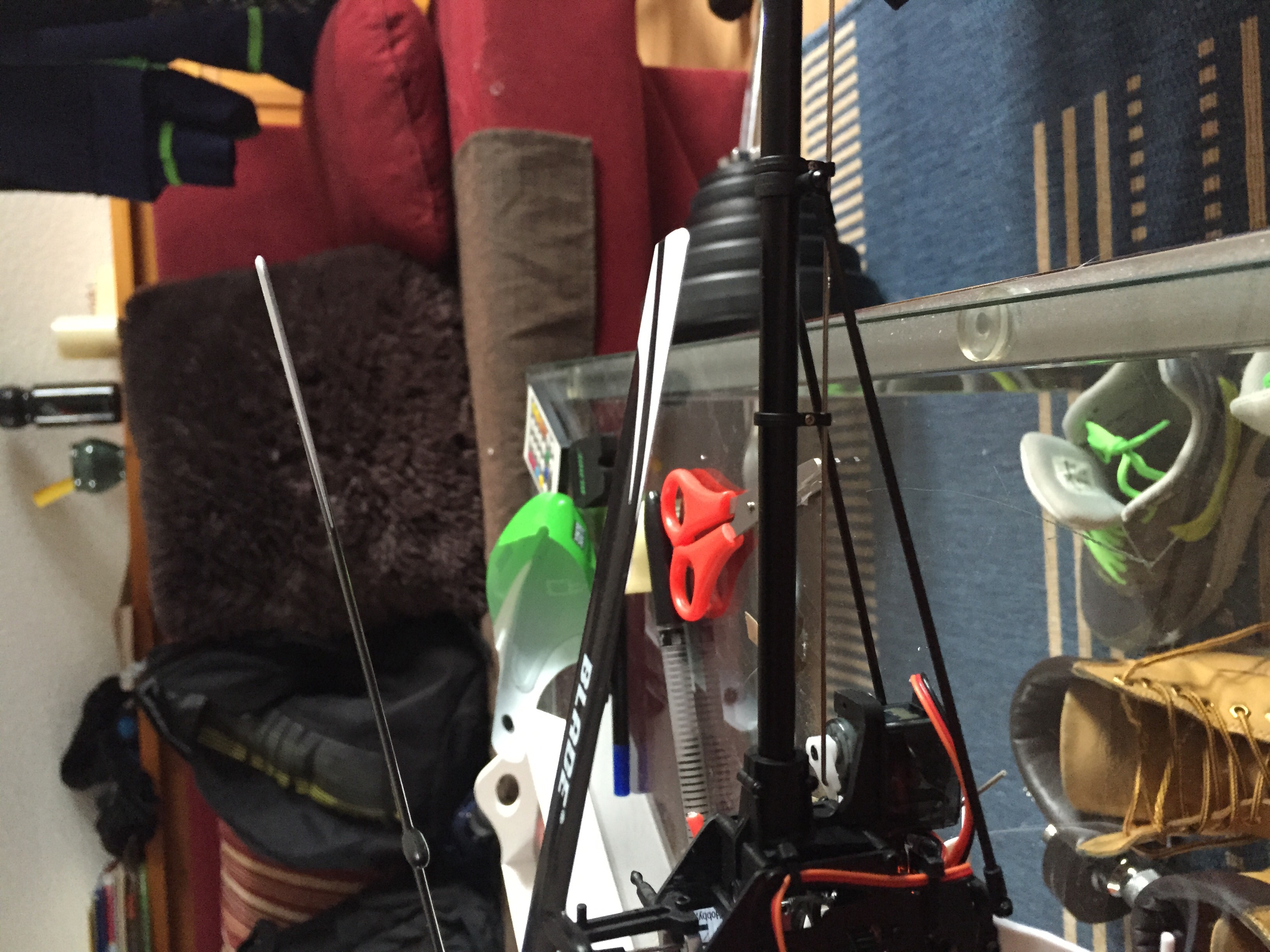

      • TheVortexOfPower
        TheVortexOfPower
        #3573
        AW: Blade 180 CFX
        Maximal Positiv : (70mm Abstand. (circa!!)
        Maximal Negativ :
        image.jpg - directupload.net
